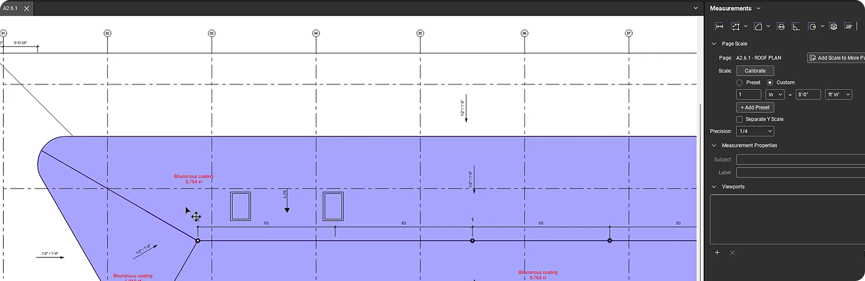

Digital takeoffs
PDF-based takeoff tools replaced scale rulers and colored pencils. On-screen measurements serve as both a visual markup and a structured data record, meaning you can see what’s been counted, how it was measured and where it sits in the scope.
Bluebeam’s takeoff tools were built around this idea. Every measurement ties to both a drawing markup and a quantity record, making takeoffs auditable by design. Features like Quantity Link connect measurements directly to Excel spreadsheets so totals update in real time as the takeoff progresses. Custom tool sets let teams standardize how quantities are captured across multiple estimators, and VisualSearch automates symbol counts that used to take hours. For a deeper look at how these tools work together in practice, see how Revu’s measurement tools support quantity takeoffs.
