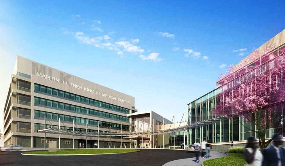

In 2011, construction began on the $208,500,000 Inpatient Tower renovation project at the Martin Luther King, Jr. Medical Center Campus in Los Angeles, California. The Inpatient Tower is slated to be completed in early 2013. Years earlier during the master planning stage the project owner, the Los Angeles Department of Public Works (LADPW), had kept the project documentation in traditional CAD format. By the middle of the scoping phase, LADPW made the decision to transition the project into Building Information Modeling (BIM). In order to make this transition seamless, CADFORCE, an architectural services provider that specializes in deploying innovative technologies, was brought on to oversee the BIM development. As LADPW’s representative, CADFORCE oversaw the coordination and delivery of all documents generated from design through construction and project turn-over, ensuring that owner’s requirements were met. To further facilitate this process, Bluebeam® Revu® was utilized as a management tool for the project’s massive repository of PDF files.
Bluebeam customer CADFORCE building rendering
