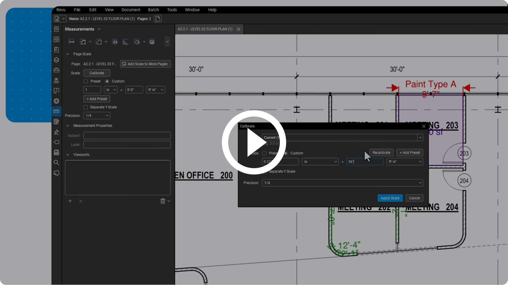

Step 2: Calibration (Non-negotiable)
Calibration is where digital accuracy is either locked in — or quietly compromised.
PDF drawings are frequently resized, scanned, or exported incorrectly. Relying on the printed scale alone is risky. Modern workflows verify scale by calibrating to a known dimension on the drawing, such as a gridline or dimension line.
With takeoff software like Bluebeam, calibration ensures every measurement taken afterward reflects real-world dimensions. Because if calibration is off, every quantity is off.
