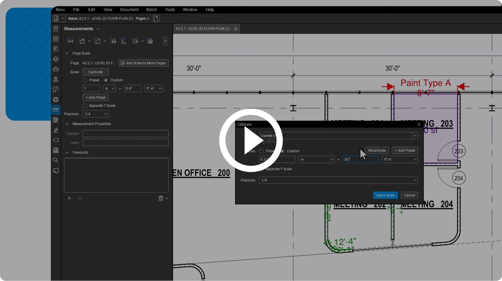

Step 2: Calibration (Non-negotiable)
Calibration is where digital accuracy is either locked in — or quietly compromised.
PDF plans are frequently resized, scanned, or exported incorrectly. Relying on the printed scale alone is risky. Modern workflows verify scale by calibrating against a known dimension on the drawing, such as a grid line or dimension string.
With takeoff software like Bluebeam, calibration ensures every measurement taken afterward reflects real-world dimensions. Because if calibration is off, every quantity is off.
